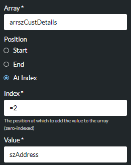

Array
Enter the array variable containing the array that will take the new value.
Position
Select the array position at which you want to insert the new value:
Note: the value will be inserted only if the array contains less than its maximum limit of values. You can use the Get Array Length action cell to check this.
Start
Inserts the new value at the start of the array (at the index position of 0) shifting all current values up by one index position.
End
(Default) Inserts the new value at the end of the array.
At Index
Inserts the new value at the index position specified in the Index property shifting all current values up by one index position.
Index
If you selected the 'At Index' option for the Position property, enter the index location (as a literal value or an integer variable) at which to insert the new value. For a maximum permitted array length of 50 values, the index must be in the range -50 and 49. A minus value counts backwards from the end of the array and facilitates adding values that are near the end of the array.

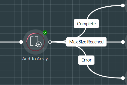

Exit Points
Exit Point
Description
Complete
This is taken if the new value was added to the specified index location and the array had still NOT reached its maximum capacity.
Max Size Reached
This is taken if the new value was added to the specified index location and the array had then reached its maximum capacity.
Error
This is taken if the specified array index location was not found or if an error has occurred.
