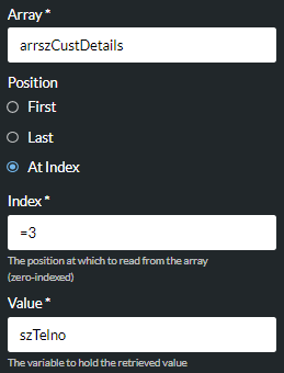

Reads a single data value from the specified location in an array variable and then stores it for use elsewhere. |
Option |
Description |
| Array |
Enter the array variable containing the array from which you want to read a value. |
| Position |
Select the array position from which you want to read the value:
Index |
If you selected the 'At Index' option for the Position property, enter the index location (as a literal value or an integer variable) from which to read the value. For a maximum permitted array length of 50 values, the index must be in the range -50 and 49. A minus value counts backwards from the end of the array and facilitates locating values that are near the end of the array. As an example, in an array containing 5 values, the indexing is as shown below:
Specifying an index of 2 or -3 reads the third value (C) in the array. Note: if you provide a positive or negative index that exceeds the number of values in the array, then execution continues along the Not Found exit point. |
Value |
Enter a string variable to store the read value. The variable type must match the data type of the array. |

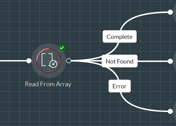

Exit Point |
Description |
Complete |
This is taken if a value was found at the specified array location. |
Not Found |
This is taken if the specified array location did not exist. |
Error |
This is taken if an error has occurred. |
