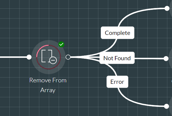

Remove From Array
Removes a single data value from a specified location in an array variable and then optionally stores it for use elsewhere.

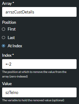

Properties
Option
Description
Array
Enter the array variable containing the array from which you want to remove the value.
Position
Select the array position from which you want to remove the value:
First
(Default) Removes the first value from the array (at the index position of 0) shifting all current values down by one index position.
Last
Removes the last value from the array (at the index position of -1).
At Index
Removes the value at the index position specified in the Index property shifting all higher indexed values down by one index position.
Index
If you selected the 'At Index' option for the Position property, enter the index location (as a literal value or an integer variable) from which to remove the value. For a maximum permitted array length of 50 values, the index must be in the range -50 and 49. A minus value counts backwards from the end of the array and facilitates removing values that are near the end of the array.

Note: if you provide an index that exceeds the number of values in the array, then execution continues along the Not Found exit point.
Value
(Optional) Enter a string variable to store the removed value. The variable type must match the data type of the array.
Exit Points
Exit Point
Description
Complete
This is taken if a value was removed from the specified index location.
Not Found
This is taken if the specified index location did not exist.
Error
This is taken if an error has occurred.
