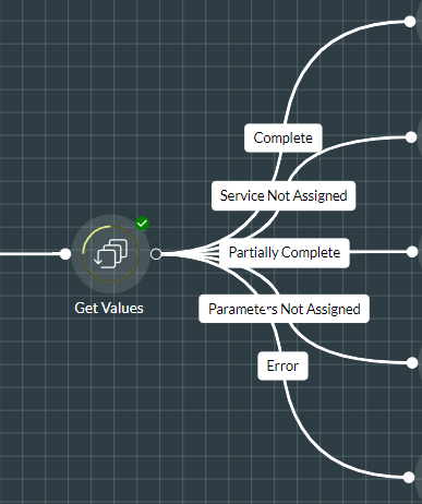

Exit Points
Exit Point
Description
Complete
This is taken when the action cell has executed successfully - all parameters specified in the action cell were assigned to the service for the access point that triggered the script and were populated at run-time.
Service Not Assigned
This is taken if the access point used to trigger the script is not assigned to a CONDUCTOR service.
Partially Complete
This is taken when the action cell has executed successfully, but not all of the parameters specified in the action cell were assigned to the CONDUCTOR service for the access point that triggered the script.
Parameters Not Assigned
This is taken if none of the parameters specified in the action cell were assigned to the service for the access point that triggered the script.
Error
This is taken if an internal error occurred.
