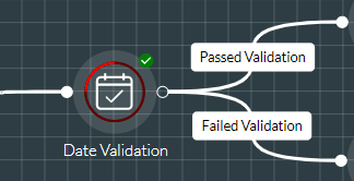

Branches according to whether a specified date is before or after the current date or equal to it. |
It can be used, for example, to check that the credit card expiry date provided by a caller during a payment transaction falls after the current date.
Option |
Description |
Variable |
Enter the date to validate as a string variable (in the format MMYY). |
Validation Type |
Select a relational operator from the list.
Option |
Description |
Passed Validation |
This is taken if the date passed validation. |
Failed Validation |
This is taken if the date failed validation. |
