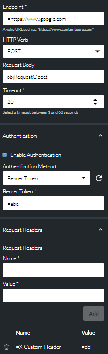

The configuration example shown on the left creates the HTTP request shown below. The object variable objRequestObject contains data members as shown in the JSON-formatted section of the request.
Note: In the header, 'Host', 'Content-Type' and 'Content-Length' are auto-generated headers and will always be present.
POST / HTTP/1.1
Host: www.google.com
Content-Type: application/json; charset=utf-8
Authorization: Bearer abc
Content-Length: 595
X-Custom-Header: def
[any additional auto-generated headers for Content Guru internal purposes]
