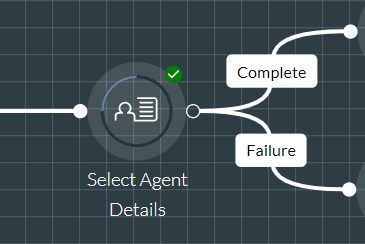

Retrieves the contact details of the next available agent servicing a queue. |
You can use these details to send an email or SMS notification to the agent ahead of them answering a contact. The details are retrieved from the agent's configuration in storm UC and CONTACT.

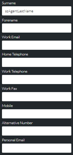

Enter string variables in the fields for the values you want to retrieve into the script. You must populate at least one field. For example:
Exit Point |
Description |
Complete |
This is taken if an available agent is found. |
Failure |
This is taken if an available agent is not found within the specified Timeout. |
