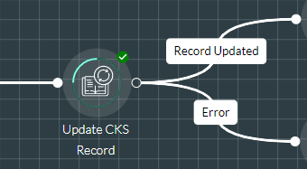

Record Updated |
This is taken if the record was updated in the CKS database. |
Error |
This is taken if the record specified in the Record ID property was not found in the CKS database or if any other error occurred. |
