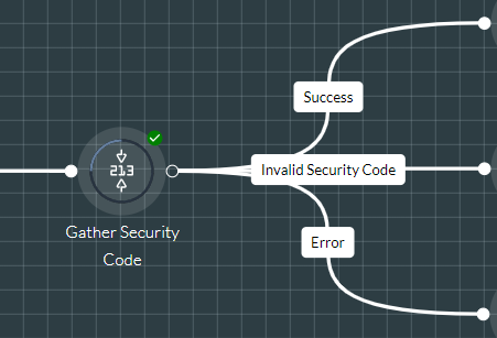

Gather Security Code
Obtains the customer's credit or debit card security number for transmission to storm LOCK.
The action cell complies with Level 1 PCI-DSS regulations regarding the handling of sensitive payment detail information. The security code is never logged or exposed to any users and is stored in the storm VIEW CONTACT data record historical data source using asterisks.

Exit Points
Exit Point
Description
Success
This is taken if the security code was validated by LOCK and has a valid format.
Invalid Security Code
This is taken if the security code was validated by LOCK but has an invalid format.
Error
This is taken if a system error occurred.
Aborted
This is taken if the customer aborted their security code entry by keying in the digit configured in the Abort Digit property.
