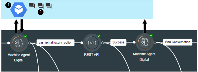

If the Dialogflow conversation needs to be interrupted for the FLOW script to perform a task such as to route the contact to a human agent via a queue or to perform an external data lookup, you must configure the action cell to exit on an appropriate intent that is configured for that agent in Dialogflow. In the illustration below, the contact has requested a luxury vehicle from the Dialogflow agent (1). The intent (2) for this request is 'car_rental_luxury_option' and is configured as an exit route from the Machine Agent Digital action cell so that the FLOW script can, at this point in the conversation, contact the vehicle provider about the availability of such vehicles. In this particular example, the script contacts the vehicle provider using a REST API action cell.
Execution then proceeds to a second Machine Agent Digital action cell that is configured with the same Dialogflow agent so that the conversation can resume.
Note: the conversation is maintained across the two Machine Agent Digital action cells because it is tied to the entire Dialogflow interaction rather than to the first Machine Agent Digital action cell.

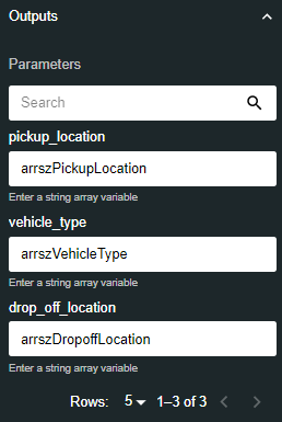

Outputs Section
(Optional) This lists all of the intent parameters configured against the agent in Dialogflow. Use this section to store the parameter values in FLOW variables.
Option
Description
Parameters
For a long list of parameters, use this to enter search text for filtering the list.
<parameter name>
Specify variables of the correct types to store the intent parameters.

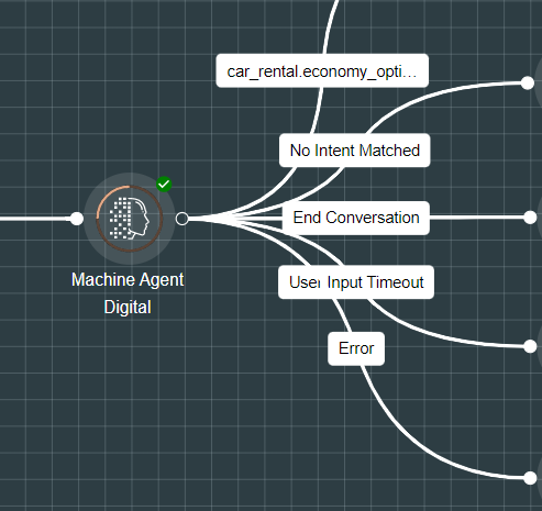

Exit Points
Exit Point
Description
<Intents>
This is taken when an intent in the Dialogflow interaction matches any of the machine agent's intents configured on this route. The branch is labelled according to the configured intents. Use this if you need to break out of the Dialogflow conversation and into the FLOW script on the basis of a contact's message.
You can create any number of Intent exit routes with multiple intents per route. A particular intent may be used on one exit route only.
Note: you must select a machine agent and save the action cell before defining this exit point.
No Intent Matched
This is taken when the number of times that the contact's input matches the agent's fallback intent exceeds the value configured in the Max Attempts property.
End Conversation
This is taken when the conversation is deemed to have ended. It is based on the underlying fulfilment setting of the previously matched intent.
User Input Timeout
This is taken when the contact has not responded to the machine agent in the duration specified in the Timeout property
Error
This is taken if there is an internal error, or an error with Dialogflow.
