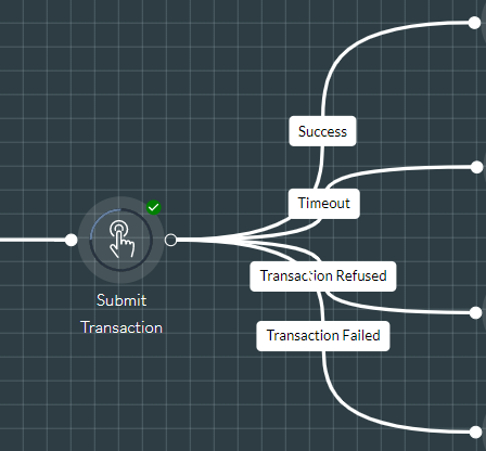

Exit Point |
Description |
Success |
This is taken if the payment succeeded. |
Timeout |
This is taken if the transaction timed out. |
Transaction Refused |
This is taken if the information was recognised by the card issuer but they refused the transaction. |
Transaction Failed |
This is taken if the transaction failed due to general errors or because the action cell was used where the action cells Gather Card Number, or Gather Security Code, or both contained invalid data. |
